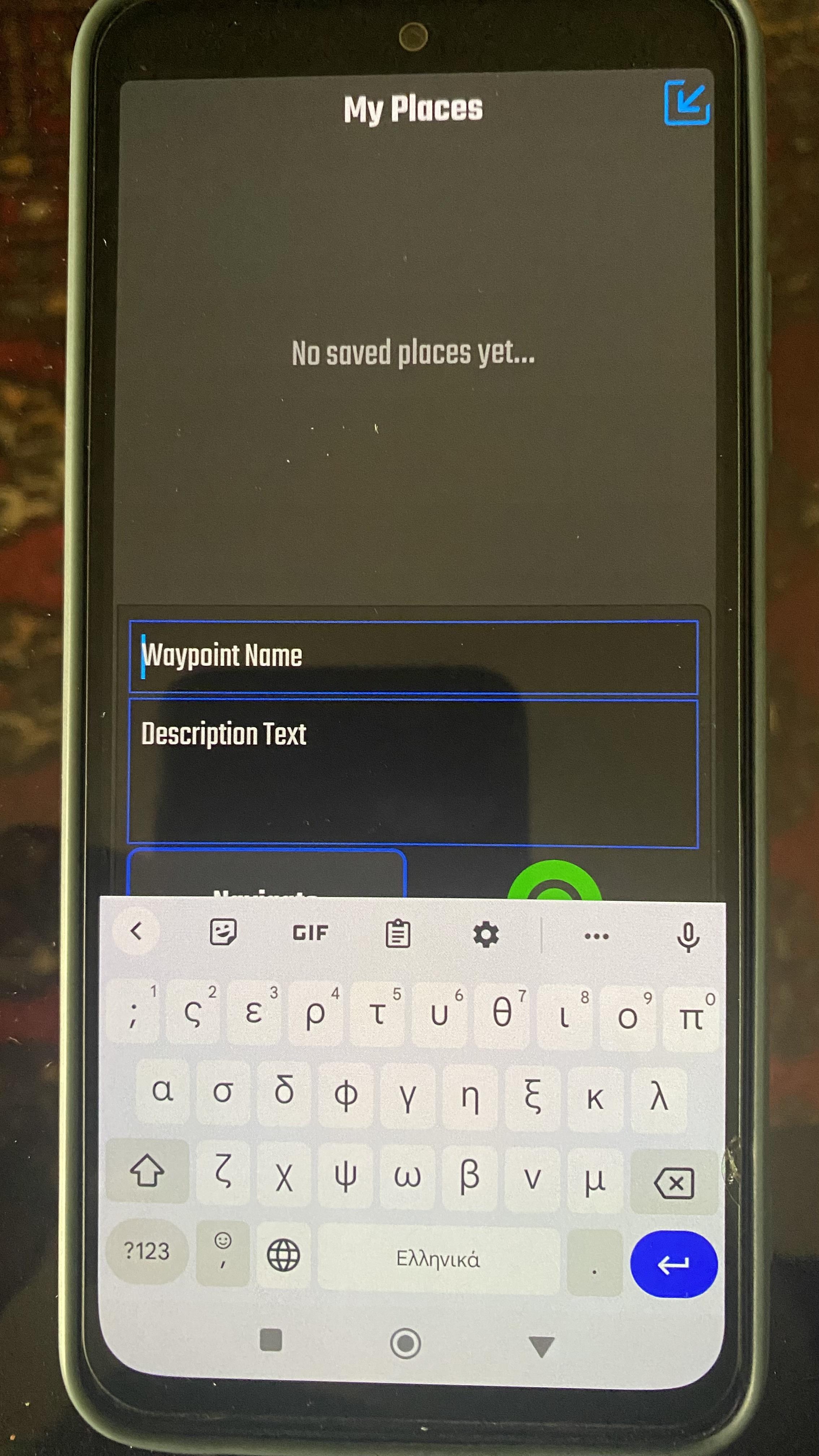

Nice add the ‘my places’ but the close keyboard icon missing so can’t continue to save one

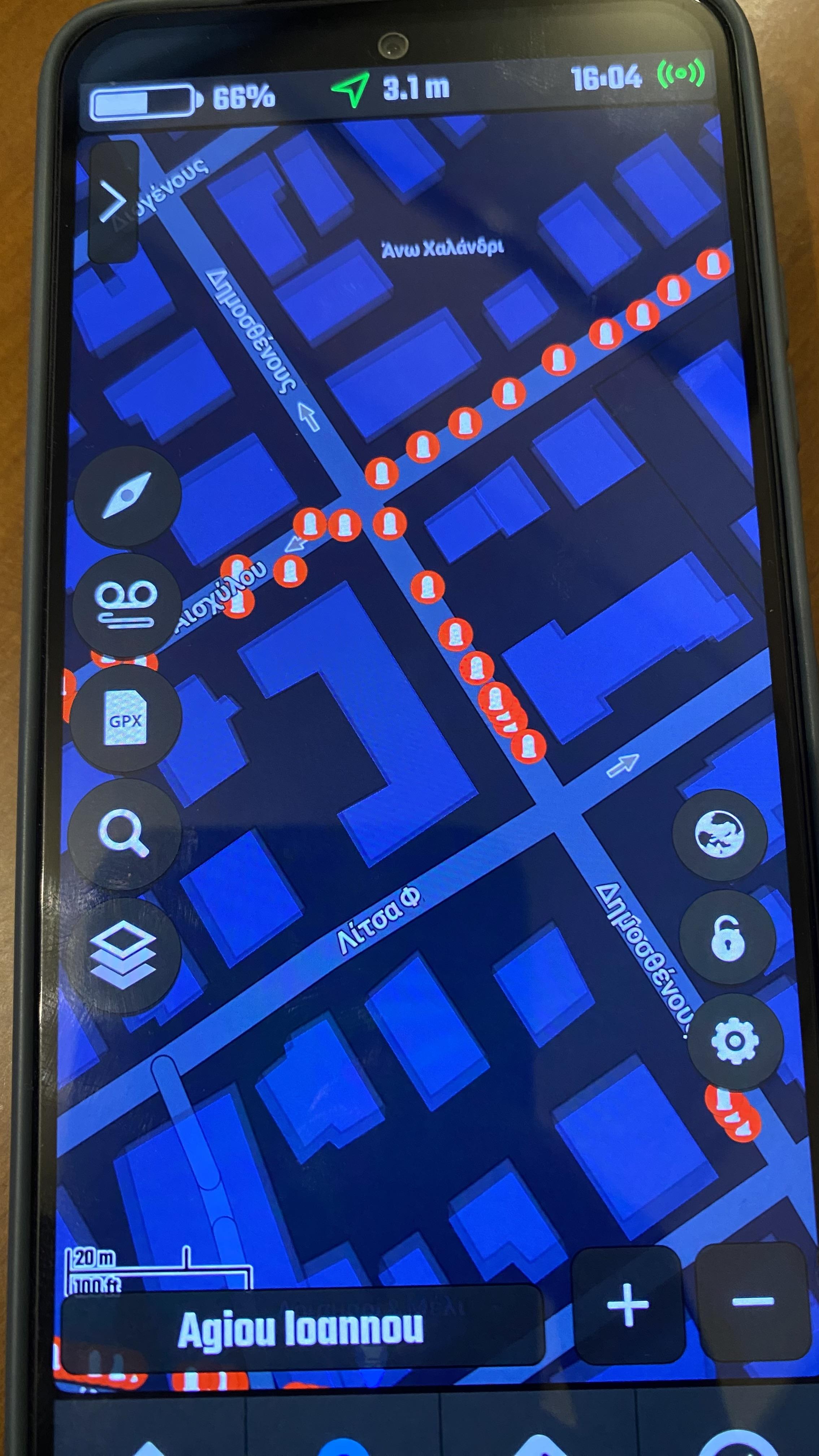

12 March 2024 at 9:13 pm #4202mp_ParticipantWhat are these bell icons?

Contribute to DMD2 Translations | Buy Me a Coffee18 March 2024 at 2:10 pm #4319João PereiraKeymasterNice add the ‘my places’ but the close keyboard icon missing so can’t continue to save one
I can see the close keyboard in the picture, its in the bottom right corner.
