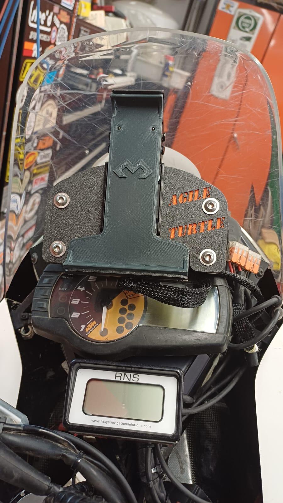

    finally, I conviced a friend to get rid of his Montana and go DMD2
    He’ll order a T865 but we wonder if the regular Amp adaptor will be enough or if we need the special longer arm (7cm if I recall correctly), because of the narrow windshield and the bigger odometer.
    (2014, R but big dash)
    We are a bit in a hurry as the next trip is in 4 weeks, no time to first order the tablet and then what needed
    Thanks for your pic if you have some

    Eric
    Tablet now received, installation planned on next weekend.
    I installed in the past few roadbook reader, gps, ICO,… on different bikes. the usual issue is to get enough room to put it where you want in the position you want
    Could be worse with a tablet and in this case I wonder if the windshield will be protective enough. pretty narrow windshiel for what I remember, will this  be a trouble source?
    My friend just called me, the T865 is not wider than the Touratech roadbook reader he has (maybe few mm, that’s it), so , looks like it will be easy.
    Regular, I mean ordinary.
    Compare to the R/G Amp Adapter which can be shifted on one axle (you can used both orientation on the T865 holder). Better safe than sorry, we ordered this one to be prepared

    #5696
    Eric
    So , it fit, windshield is large enough.
    We should have choose the special 7cm extension (because of the 2015 larger ODO), But we were able to build someting ok
    • This reply was modified 11 months, 2 weeks ago by Eric.
    #5698
    Eric
    By the way, pogo pin cover is not from me, STL file found on the net
    https://cults3d.com/fr/mod%C3%A8le-3d/divers/dmd-t865-holder-cover
