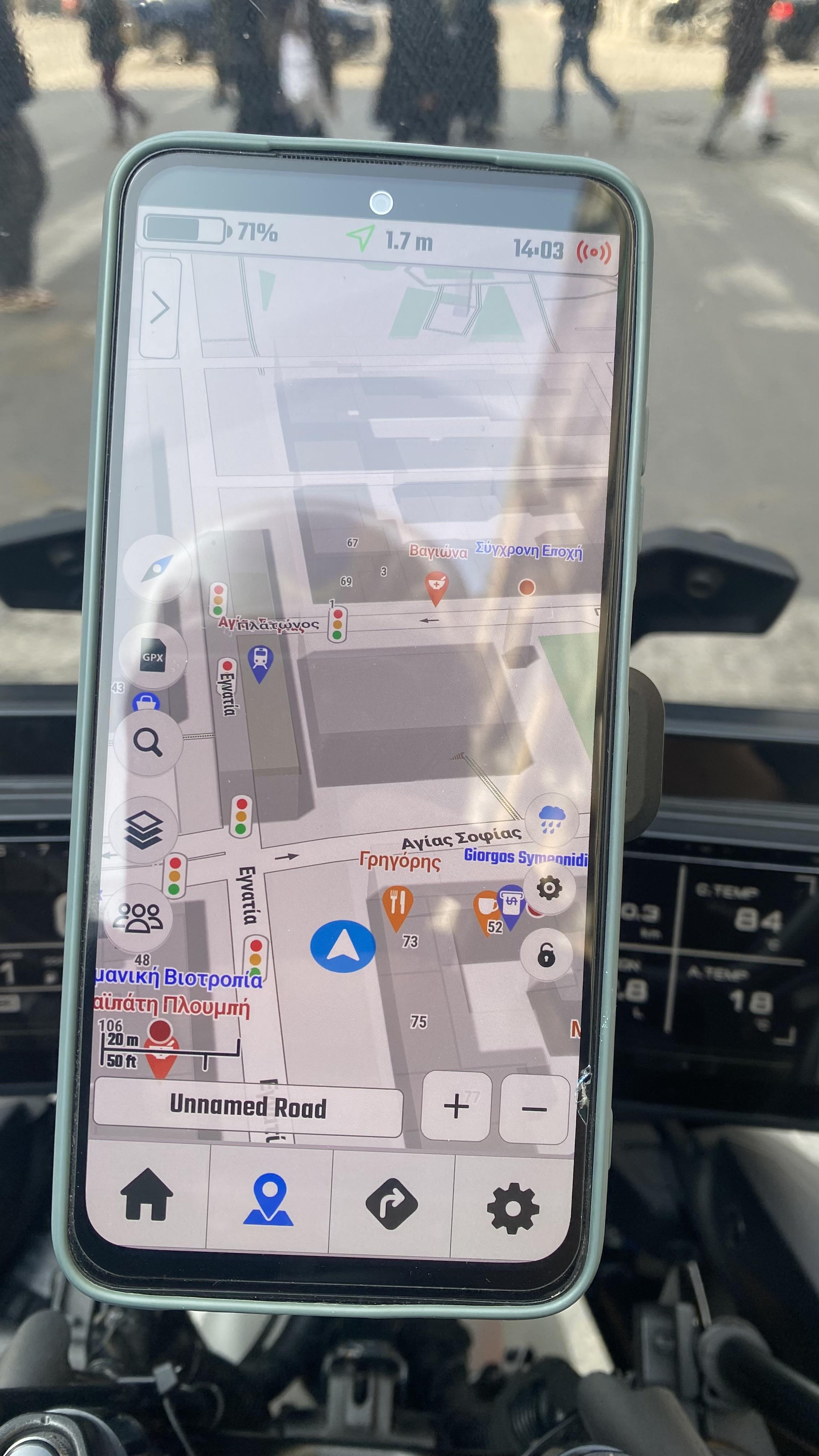

    I understand that this is useful for off-road adventures, but for road rides, it sucks. Many times, the icon appears outside the road or even inside buildings. As Patrick mentioned, when there’s a parallel road, it can be confusing. Could you add an option for ‘road snapping,’ whether it’s for GPX files or navigating from point A to B?
    Another thing I noticed is that when 3D buildings are enabled, especially with shadows, some buildings appear to be ‘dropped’ onto the road. Could you add a ‘cut’ or something in the shadows when a building is near the road?
    One more request that might be easy to implement: could you use a different color for boulevard/avenue roads?

    Absolutely not. It’s out there in the middle of nowhere, doing its own thing and proving to be completely useless—so much so that it frustrates me during my rides. It’s really that bad. I initially thought the issue was with the Tripltek 9, but since it works fine with OSMAND, it seems to be a problem on the DMD side. I’m somewhat relieved to realize that I don’t need to invest in new hardware to fix this.
    Please consider adding some kind of snapping option or whatever fix to make this frustration go away.
