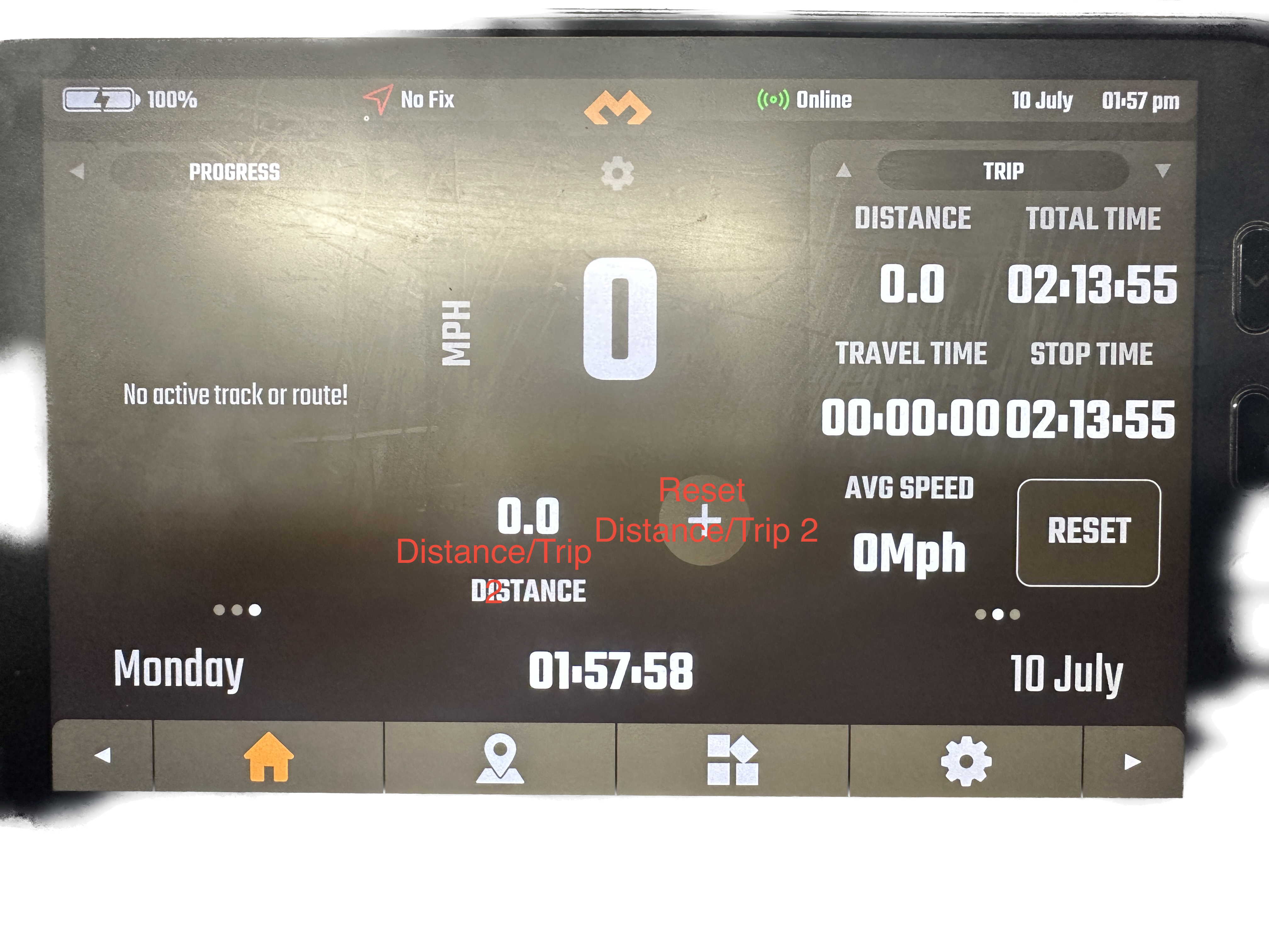

    Feature Request
    Might it be possible to add a Distance/Trip 2 with separate reset for those of us on Enduro/Dirt bikes without a fuel gauge? App is great!!
