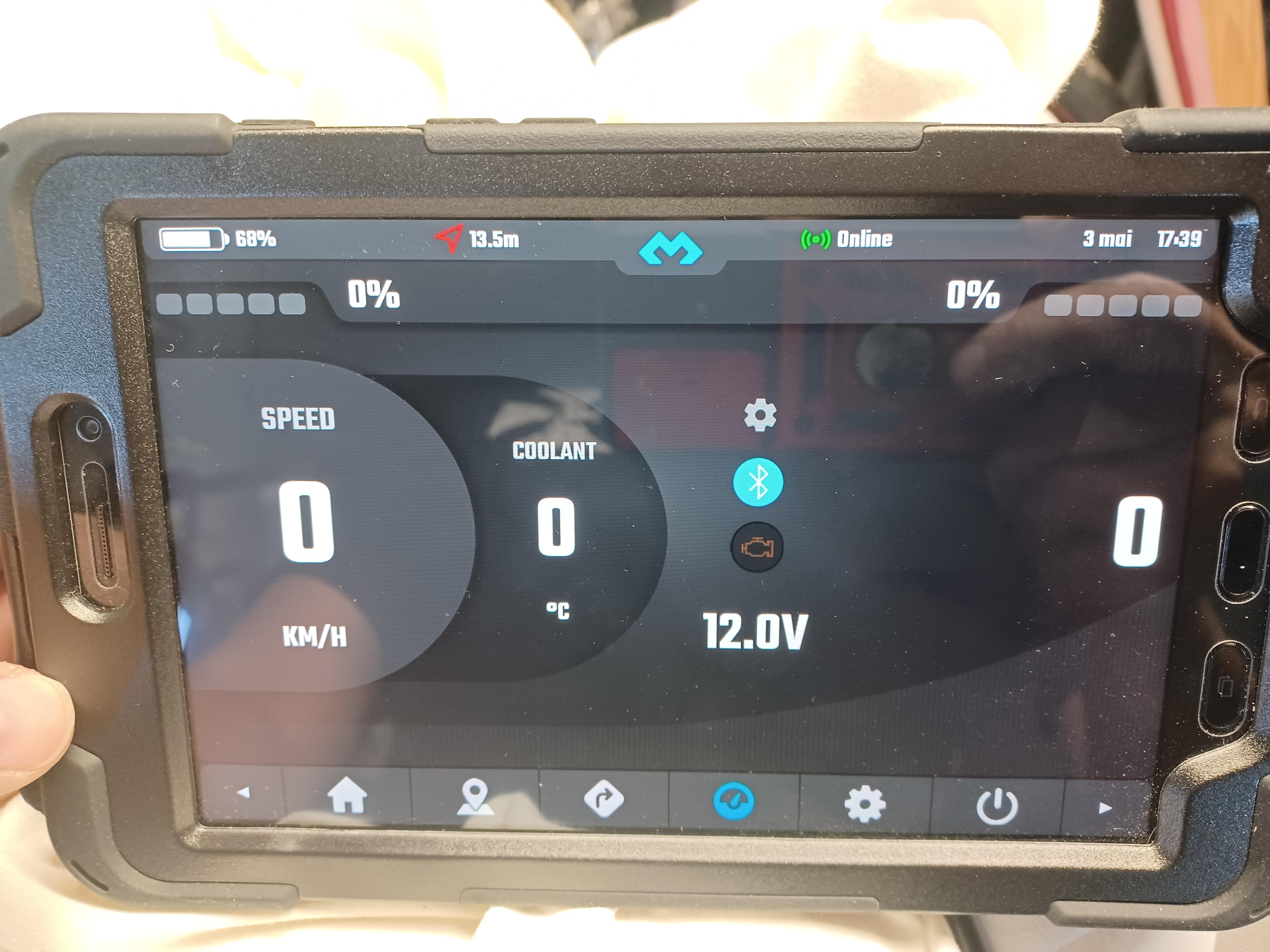

    MaxGaudon
    Hi
    I install the bêta version, and purchase the obd plugin, but nothing on the screen, just the voltage is displayed.
    I tried on 3 different android, still the same result.
    Obdlink LX + 1200 GSA 2016
    Impossibility to store maps on sd card.
    I go for 3 days run and I have to go back to older version.
    Good luck to the team ✌️
