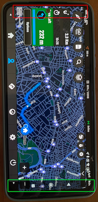

    Can you add an option to have a space in the top (red rectangle) as exists in portrait view and another one for bottom navigation from mobile (green rectangle). I know that this will shrink the layout a bit but at least I could easily switch to another app the map/info won’t be in the camera and will fix the cut in the corners a bit.
