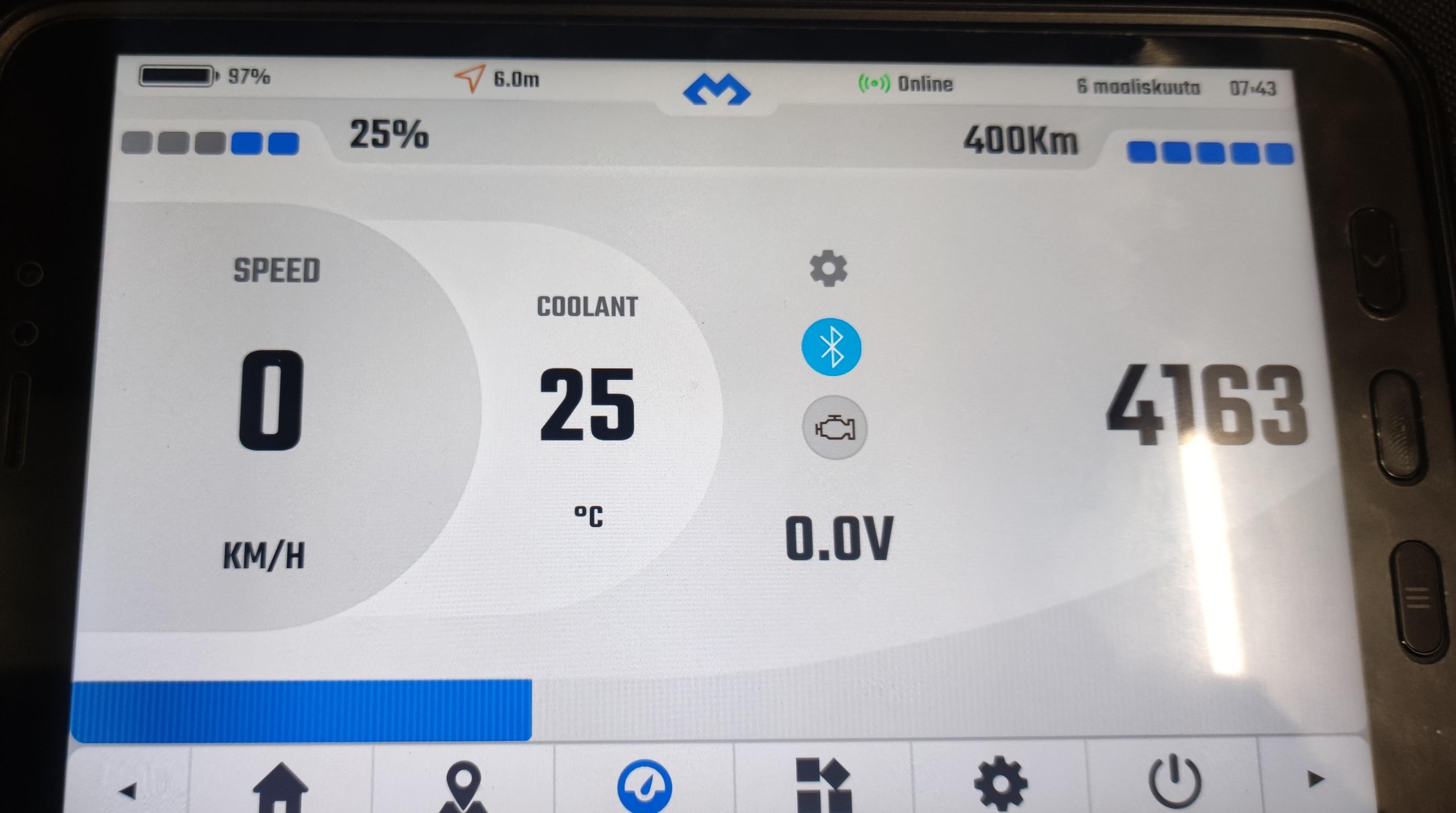

    Ejj75
    Beta 2.95 + Samsung Active 3 + ODBLink LX + Yamaha Tracer 9 GT
    ODB link connection issue showed up again with version 2.95.
    ODBLink in sleep mode
    Wake up Samsung and DMD2
    Switch ignition on => ODB reading in stuck, RPM 4163
    Reboot DMD2 application / Reboot whole Tablet if DMD2 is default launcher => ODB reading start working.
    #1363
    Ejj75
    I want report another ODBLink LX / DMD2 connection stuck issue.
    Beta 2.95 + ODBlink LX + Yamaha Tracer 9 GT + Samsung Active 3 + DMD2 default launcher.
    OBDlink LX can be in sleep or wake mode.
    The motorcycle is turned off.
    Samsung is put into standby mode / screen off.
    Start motorcycle and Samsung.
    The DMD2 bluetooth icon remains red and values are stuck (see photo below).
    Samsung own settings shows that ODBLink is paired.
    DMD2 and ODBLink BT do not connect.
    Re-pairing ODBlink/Samsung does not solve connection problem.
    Only Samsung reboot will connect ODBlink and DMD2.
    The same happens if DMD2 is not the default launcher. Then BT reconnection can be done by restart the DMD2 application.

    I want report another ODBLink LX / DMD2 connection stuck issue. Beta 2.95 + ODBlink LX + Yamaha Tracer 9 GT + Samsung Active 3 + DMD2 default launcher. OBDlink LX can be in sleep or wake mode. The motorcycle is turned off. Samsung is put into standby mode / screen off. Start motorcycle and Samsung. The DMD2 bluetooth icon remains red and values are stuck (see photo below). Samsung own settings shows that ODBLink is paired. DMD2 and ODBLink BT do not connect. Re-pairing ODBlink/Samsung does not solve connection problem. Only Samsung reboot will connect ODBlink and DMD2. The same happens if DMD2 is not the default launcher. Then BT reconnection can be done by restart the DMD2 application.
    When you say that the Samsung tab is in “sleep mode” is it in sleep mode with DMD2 running (either in the background or foreground)?
    #1383
    Ejj75
    DMD2 is set as default launcher. It is on screen, push to side key and Tablet enter to sleep mode. At least display shut down. I do not know what else Samsung does. When I push side key again Samsung wakes up and DMD2 launcher works expect DMD2 BT connection with ODB lx.
    User manual: Power key (or Side key) – The power/side key powers the Tab Active on and off. In addition, the user can tap the button to enter Awake/Sleep mode.
    More info after tablet wake up:
    The voltage value (e.g. 11.9V) is immediately displayed and the BT indicator is red (in failing case). When the connection is successful, the first voltage value is initially zero, and the reading becomes correct when the BT indicator turns blue.
    • This reply was modified 8 months, 3 weeks ago by Ejj75.
    #1390
    When you say that the Samsung tab is in “sleep mode” is it in sleep mode with DMD2 running (either in the background or foreground)? DMD2 is set as default launcher. It is on screen, push to side key and Tablet enter to sleep mode. At least display shut down. I do not know what else Samsung does. When I push side key again Samsung wakes up and DMD2 launcher works expect DMD2 BT connection with ODB lx. User manual: Power key (or Side key) – The power/side key powers the Tab Active on and off. In addition, the user can tap the button to enter Awake/Sleep mode. More info after tablet wake up: The voltage value (e.g. 11.9V) is immediately displayed and the BT indicator is red (in failing case). When the connection is successful, the first voltage value is initially zero, and the reading becomes correct when the BT indicator turns blue.
    Seems like Samsung is killing the OBD Service in a not so good way. Will try to reproduce this.
