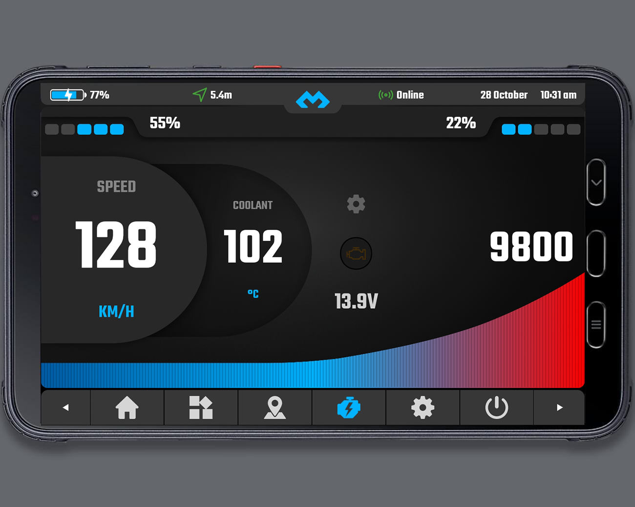

    This is the current progress on the new OBD view.
    It will include the final stable OBD code and new layout.
    WORK IN PROGRESS:

    DMD2 OBDView is finally reached its first stable release!
    Ready to be included in the next DMD2 big update.
    Today we finished it and we are now moving to the Roadbook view.

    Ohhh nice! Well im really not sure it is OBD2 compliant, but you can test with the current DMD2 version available in the Google Play Store.

    Which widget could one install on the DMD2 dash on a T665 connected to the Thork dongle to get error messages from the bike? Would be very nice to sort out errors while stranded deep in the bush!
    DMD does that by default, the OBDView will show you the DTC error light if there is any error, if you tap on it when its lit then you get a list of active errors.
