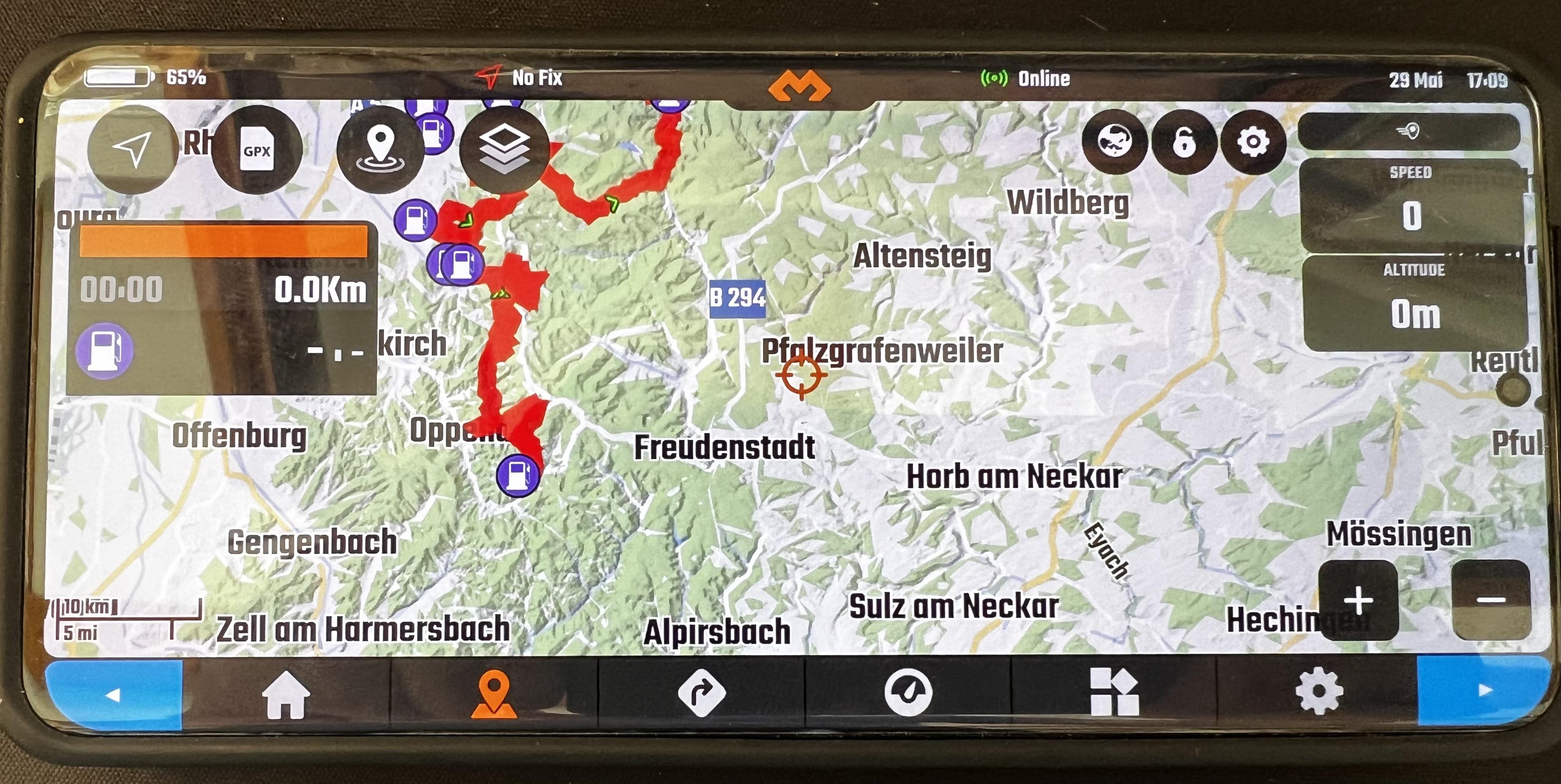

    rrawer
    I tried the long-press of the top button again – it does not disable Panmode but only highlights both arrows in the bottom menu blue (see image) and the only way to get rid of teh color marking was to switch on and off the lock in Map Mode…Screenshot
