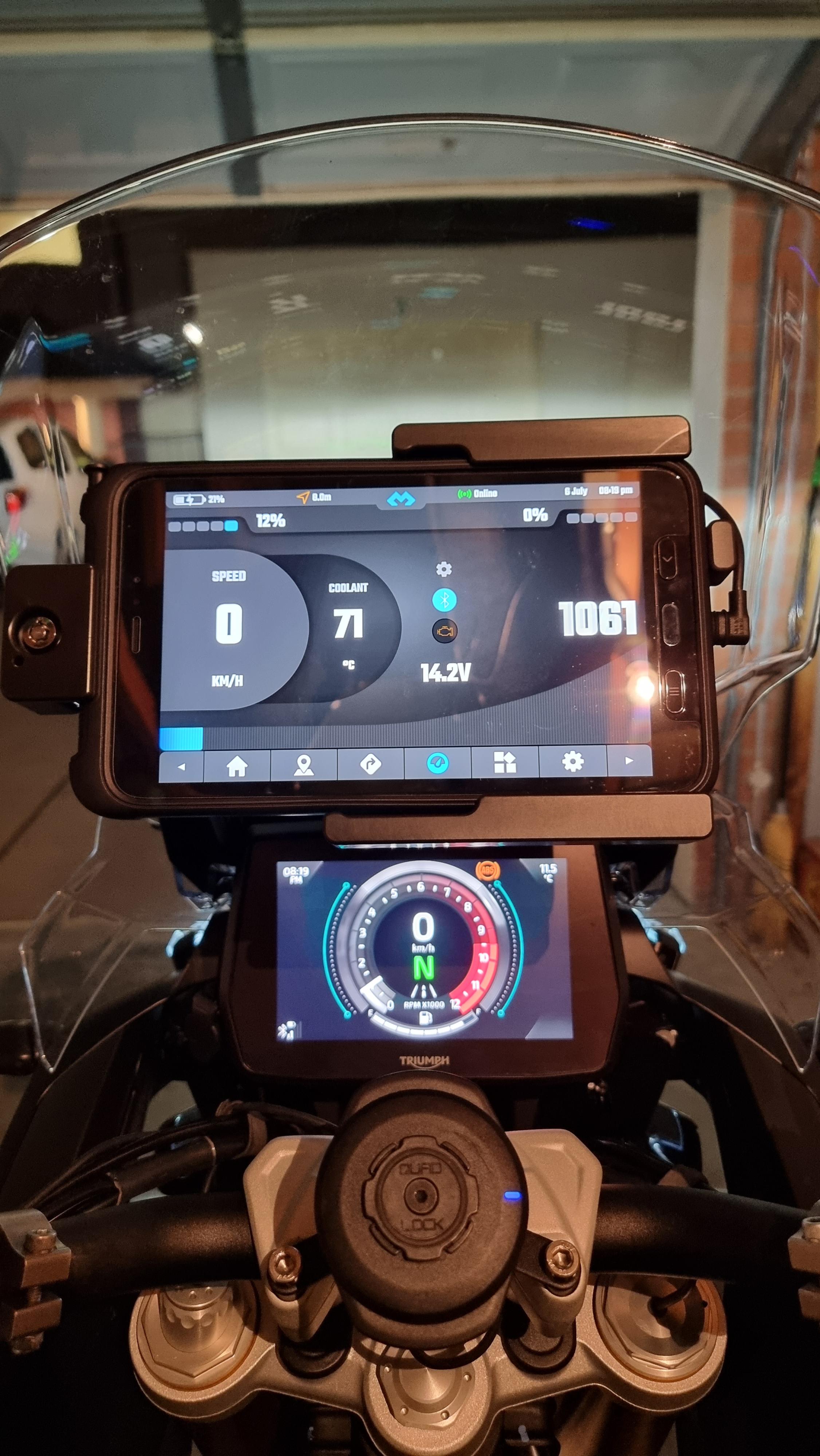

I just put on my Samsung Galaxy Active Tab 3 with DMD2 on my Triumph Tiger 1200 Rally Pro. I’m pretty impressed with the results. What do you think?
This is looking really nice. But isnt it to big on top of the tachometer? Which parts did you use to made the hardware installation? I have a Tiger 900 GT and try to find a solution which will fit to me. Would be nice to get some informations and help. THX and Regards.

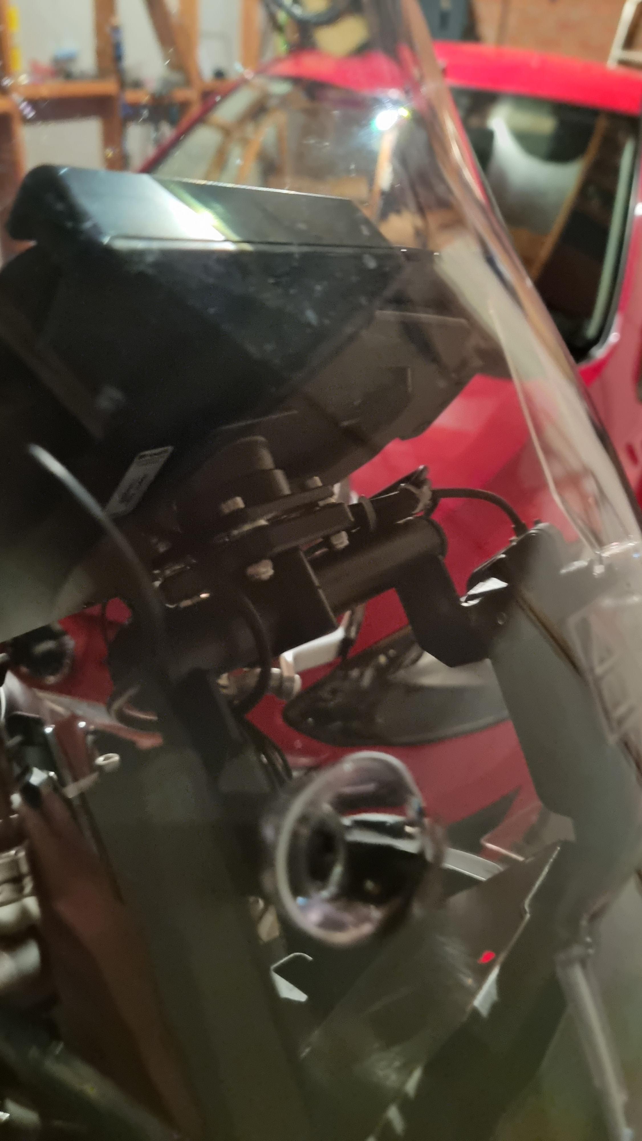

Thanks for your comments. I like that the tablet is bigger then my TFT, just my personal preference. The image seen is from the Brodit holder (swivel ball) mount to the 22mm Cosmo bar mount. The Brodit fits an AMPS holes. In between the Brodit mount and the Cosmo 22mm bar mount, I have some spring washers to put more tension on the screws with lock nuts at the end. The Brodit mount is positioned against the screen on the top so there is very little vibration of the tablet,
22mm 22mm GPS Navigator GPS Bracket Mount Fit For Triumph: https://www.ebay.com.au/itm/363851674294
