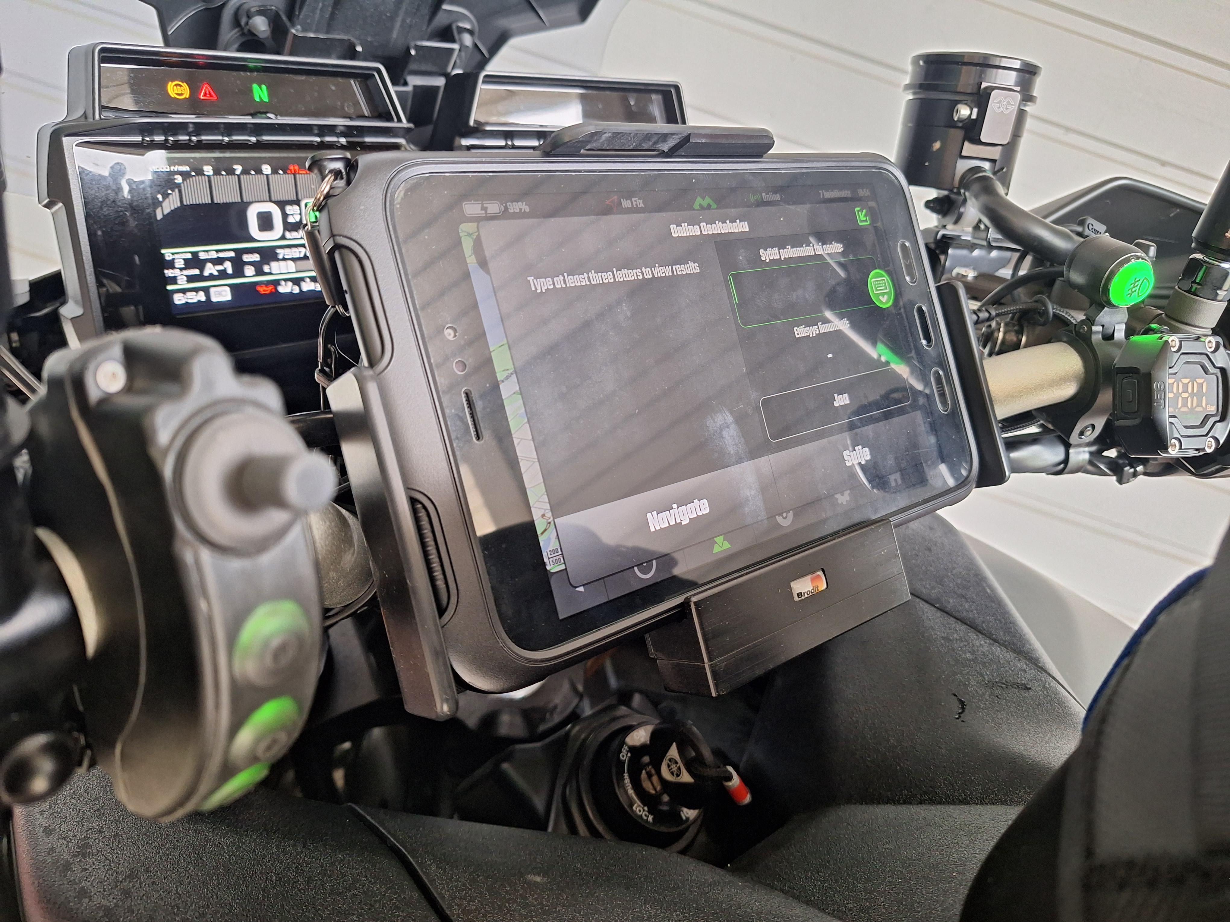

If Adventure Controller is connected and I try type navigation address keyboard is missing.
Keyboard can open if I push joystic up and chose F5 from bottom.
If Adv. Controller is not connected the keyboard appears immediately when open type address.
EDIT: Sorry, This is not bug. Found solution from Android setting language / physical keyboard. Enable: Show on screen keyboard
