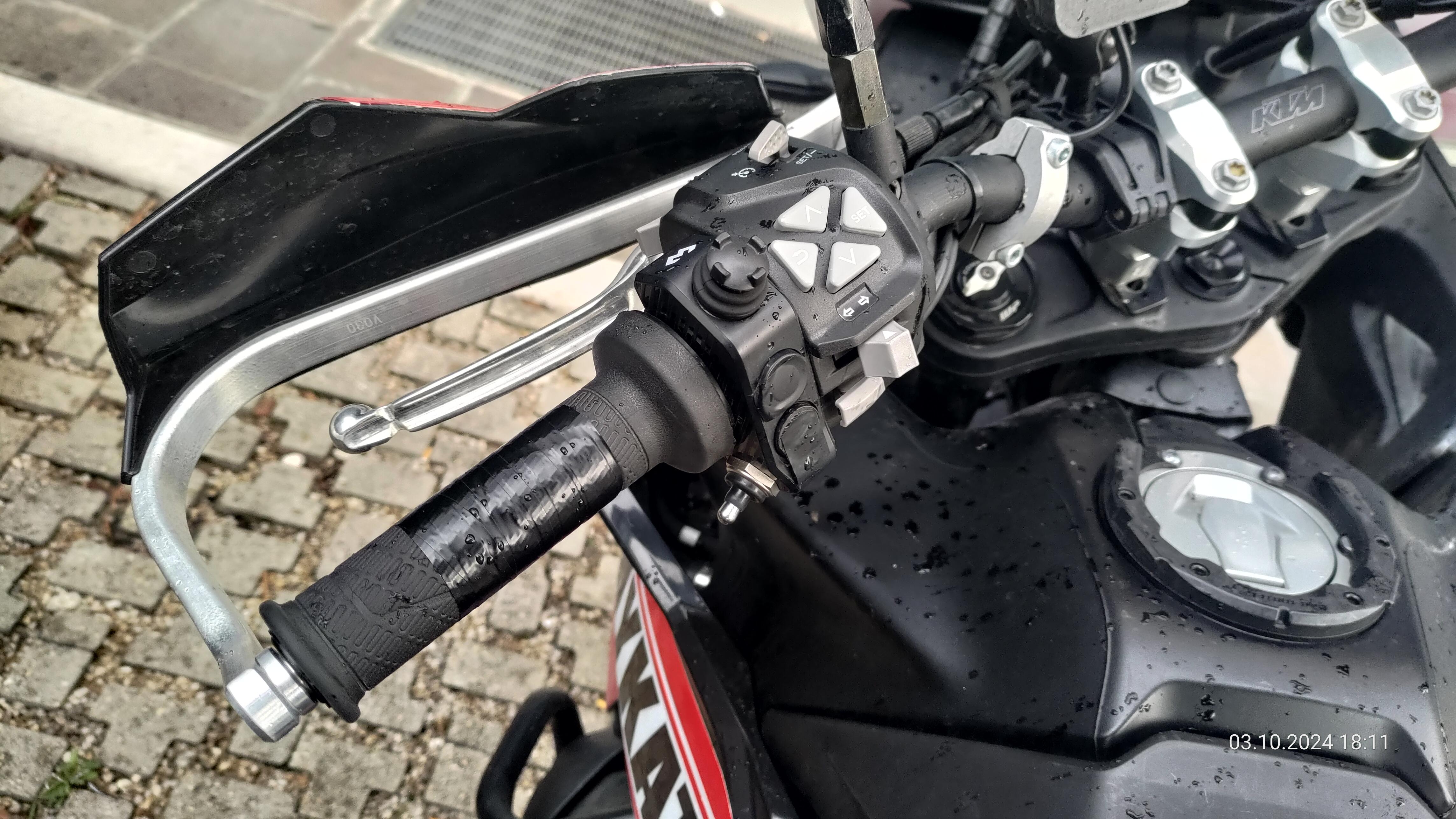

    I am new to the community.  I have a 2020 KTM 790 Adventure R with cruise control and heated grips on the left hand side of the bike. I am interested in the DMD system with the remote control setup.  I would love to see pics for anyone with this bike and those features with a DMD remote controller on their bike.  Thanks again.

    if you would like to use a remote control with your DMD system (or other system) – you need to shift your bracket for left mirror and left switch housing.
    I prefer to use the DMD Controller2 because it’s a small device; others are not so comfortable.
    In use, you need to lern, not to hit 4way-joystick of controller, if you would like activate/deactive KTM’s cruise control  😉

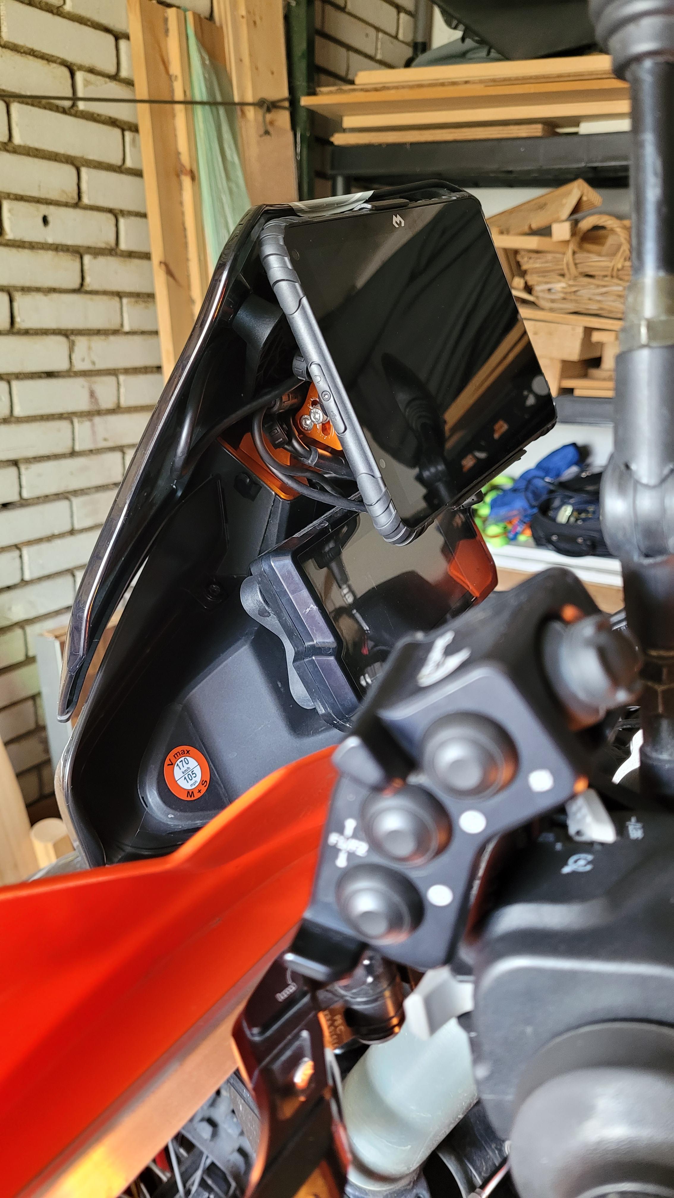

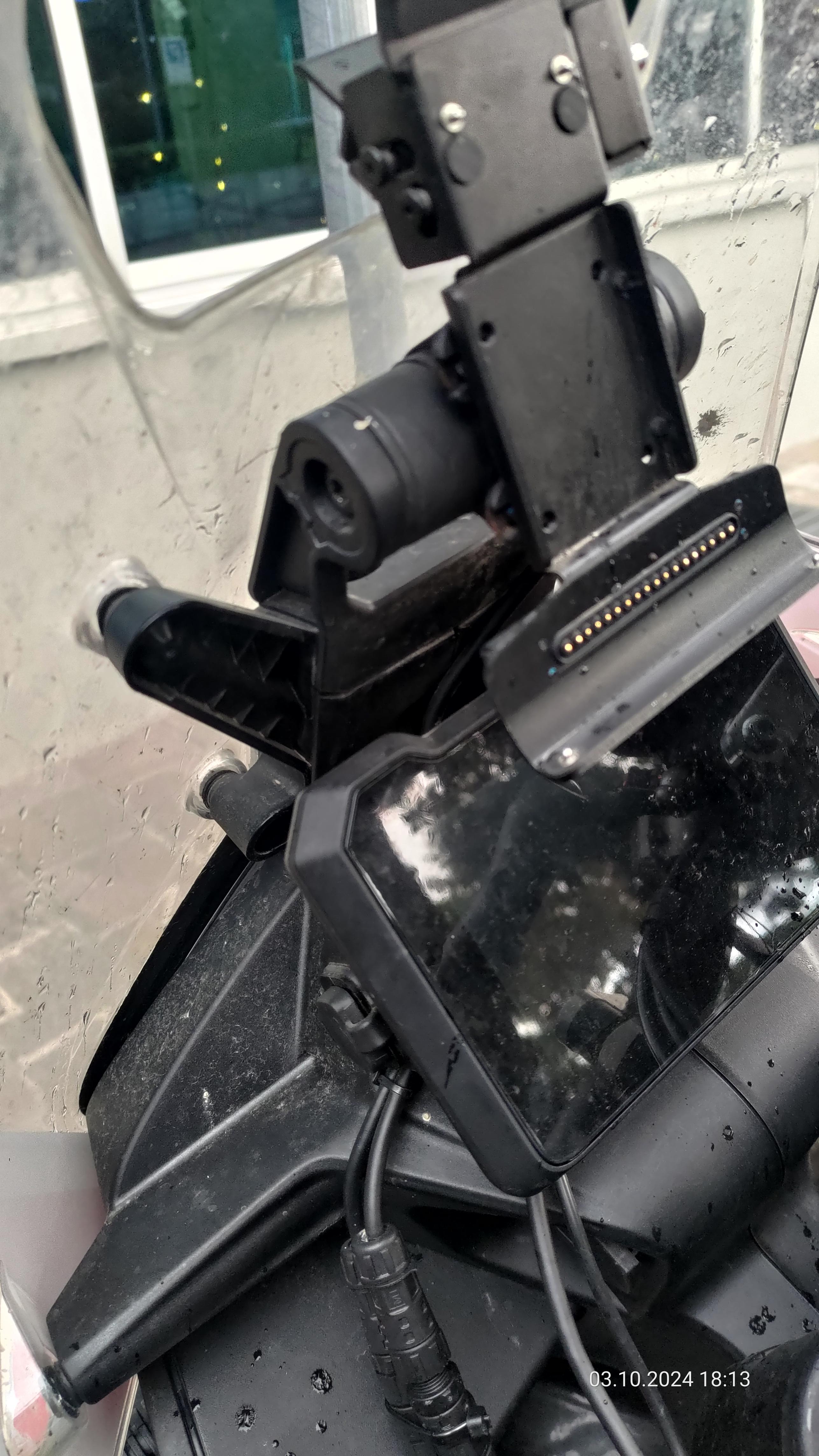

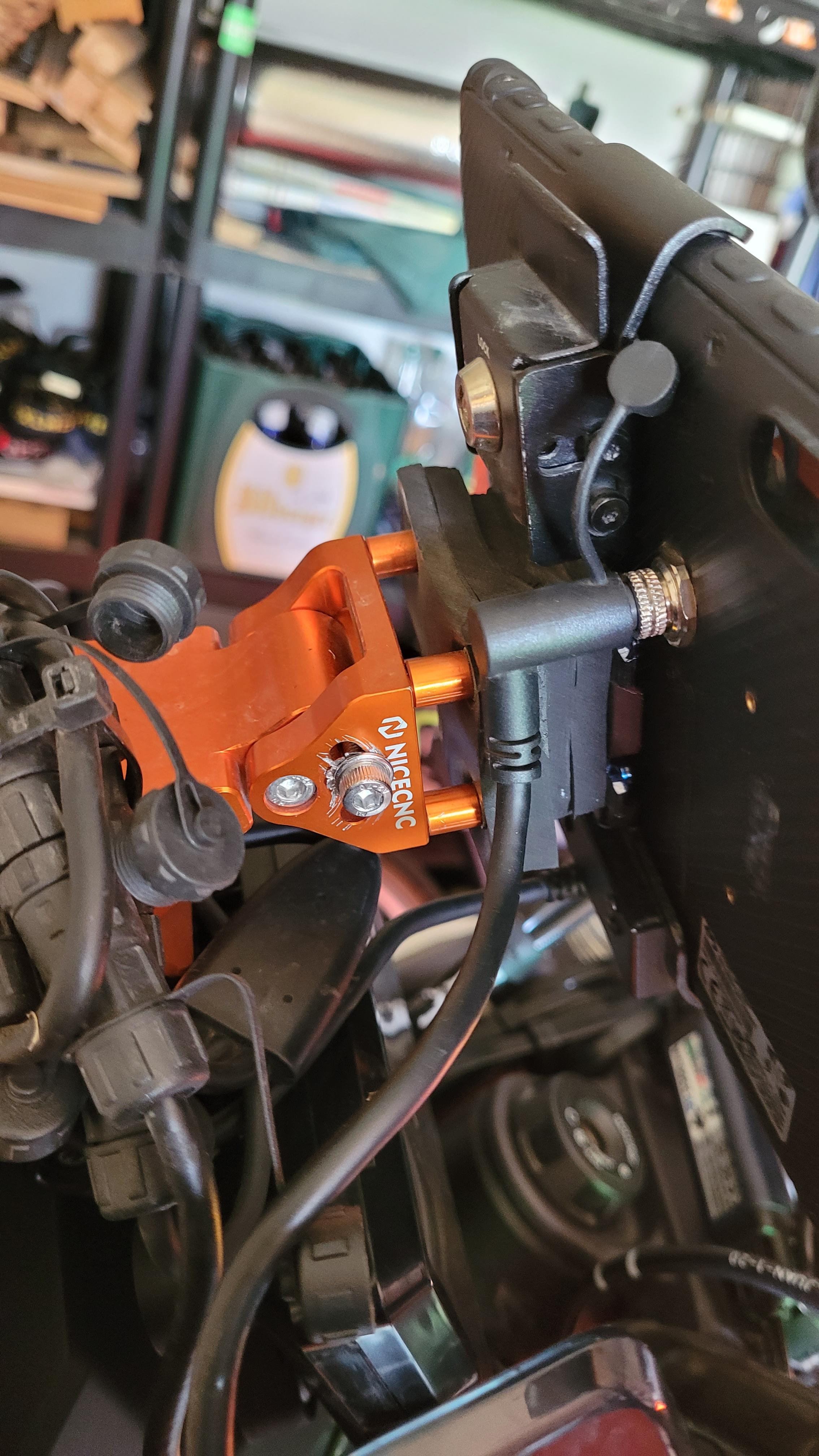

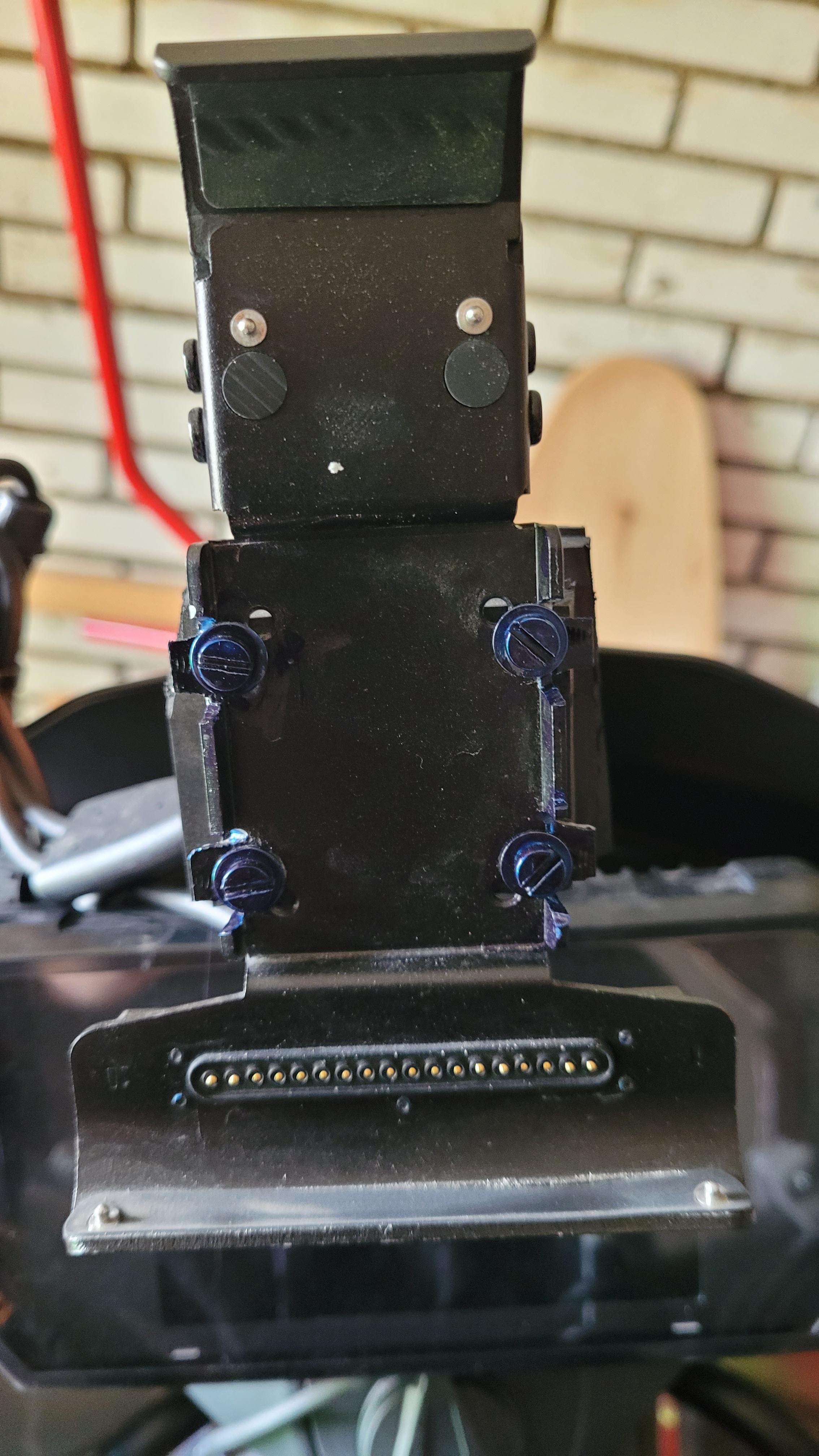

    tetty
    Hi just seen your post.
    I have the following set up shown below.
    Power is coming from the Switched ACC cable in the headlight. I used a cheaper  holder from ebay (Orange) and then I used longer screws to go through the holder and into the mount orange. I also filled up the distance required with rubber blocks to help with vibration and incase handle bars hit DMD tablet on crash.
    Note to fit the longer bolts I had to cut the raised sides from the tablet holder so the heads would fit, so far it has held up on ACT Italy / TET routes with no problems. All cables fit nice between the Tablet and small windscreen
