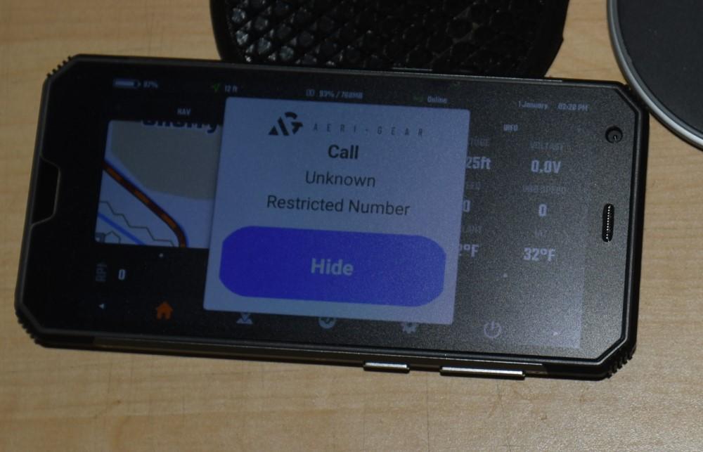

Found an app that works, but its unintuitive and has zero documentation on it, its called NotifMate by Aeri-Gear. Even their website has zero info about the app, but it is on Google’s Play store.
Fumbled through the app’s settings and it seems to do exactly what I’m wanting it to do, although the phone call push message does not show the correct info, just says uknown restricted number, here’s a shot of it:

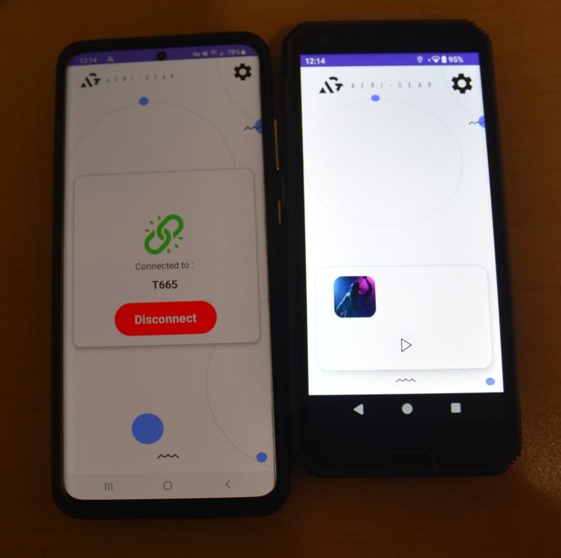

This is the screen shot of how they look when paired:
see last photo below
I don’t have music on the T665, that’s done on the S20, so that right screen at the bottom doesn’t seem to show anything useful, and setting PowerAmp (my music app on my S20) to push notifications doesn’t really do anything on the T665, but I’m okay with that.
Waiting to hear back from the company, I emailed them yesterday and hope to hear back soon about any documentation for the app so it becomes clear on how to configure it. Its snowy now so no riding to test the app out, but within my shop, it seems to work almost perfectly! I think this one is a keeper, and if Joao or John@Thork are reading this, perhaps you guys could work with Aeri-Gear to have this as an add-on to your fantastic DMD2 app! What a fantastic add-on this would be for many of us who have one of your units as well as a main cellphone for all of our data/cell stuff!!!
